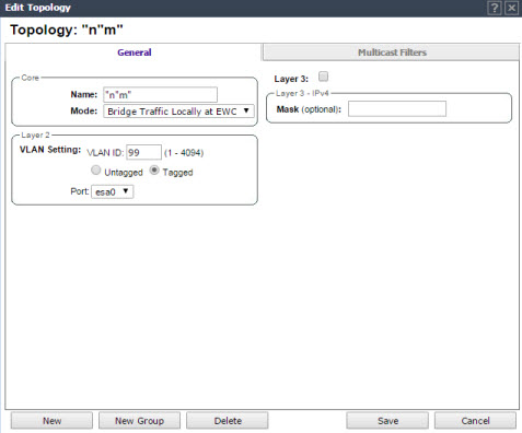

  3. To change any of the associated parameters, click on the topology entry to be modified. The Edit Topology dialog appears.
    Graphics/L2_port_edit_topology.jpg
    For the data ports predefined in the system, Name and Mode are not configurable.

  5. To configure an interface for VLAN assignment, configure the VLAN Settings in the Layer 2 box.
    When you configure a controller port to be a member of a VLAN, you must ensure that the VLAN configuration (VLAN ID, tagged or untagged attribute, and Port ID) is matched with the correct configuration on the network switch.

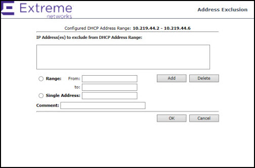

    8. Click the Exclusion(s) button to exclude IP addresses from allocation by the DHCP Server. The DHCP Address Exclusion window opens.
    The controller automatically adds the IP addresses of the Interfaces (Ports), and the default gateway to the exclusion list. You cannot remove these IP addresses from the exclusion list.
    Graphics/DHCExclusionWindow.jpg
    • Select Range. In the From box, type the starting IP address of the IP address range that you want to exclude from the DHCP allocation.
    • In the To box, type the ending IP address of the IP address range that you want to exclude from the DHCP allocation.
    • To exclude a single address, select the Single Address radio button and type the IP address in the adjacent box.
    • In the Comment box, type any relevant comment. For example, you can type the reason for which a certain IP address is excluded from the DHCP allocation.
    • Click Add. The excluded IP addresses are displayed in the IP Address(es) to exclude from DHCP Address Range box.
    • To delete a IP Address from the exclusion list, select it in the IP Address(es) to exclude from DHCP Range box, and then click Delete.
    • To save your changes, click OK.
