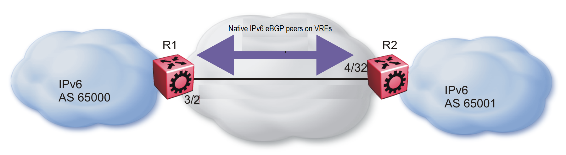

The following figure shows a sample network that contains native IPv6 eBGP peers on VRFs.
Configure the local AS first on GRT (and it is inherited by all VRFs), and then enable BGP on GRT/VRF.
You must configure the address-family ipv6 option for IPv6 peers, otherwise, peer-ship is formed, but no routing updates between them will take place.
You must configure the ebgp-multihop option for the given eBGP peer that is not on one of local subnets (remote peers), otherwise, peer-ship will not be formed.
The switch does not accept any configuration command for BGP in router-vrf configuration mode unless a BGP instance associated to the VRF context is created. You can use ip bgp command in router-vrf configuration mode to create a BGP instance on VRF.
