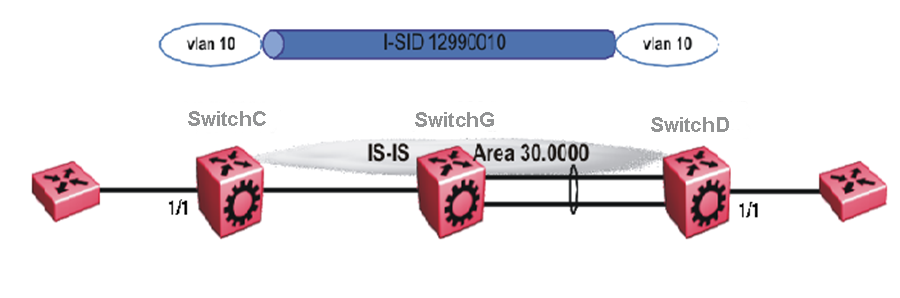

The following figure shows a sample Layer 2 VSN deployment.
The following sections show the steps required to configure the Layer 2 VSN parameters in this example. You must first configure basic SPBM and IS-IS infrastructure. For more information, see: SPBM configuration examples.
VLAN CONFIGURATION vlan create 10 type port-mstprstp 1 vlan members 10 1/1 portmember vlan i-sid 10 12990010
