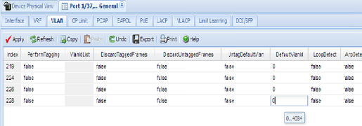

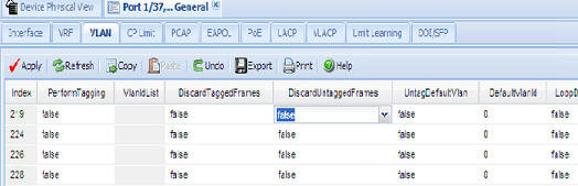

             - Select a table-based
tab.
 - Double-click a white-shaded
field to edit the value.
                Select the arrow in the list
                    field to view the options, and then choose the appropriate value.
                Double-click a text-entry field
                    and edit the value.
                Select Apply to save the
                    configuration changes.
