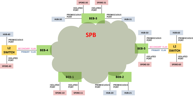

The following figure shows a basic E-Tree network topology consisting of groups of private VLANs connected by the SPBM core network.
Sample E-Tree configuration
Private VLAN port types
The private VLAN port type is isolated, promiscuous, or trunk. If the port is a member of an MLT, then the port inherits the private VLAN type of the MLT.
In terms of network topology, the isolated port is considered a spoke. The isolated port, or spoke, does not communicate with any other isolated port in the network. The isolated port only communicates with the promiscuous ports, or hubs.
