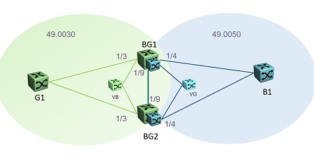

The following sections display an example to configure the two boundary nodes in the Multi-area SPB network (BG1 and BG2), to enable remote Intermediate-System-to-Intermediate-System (IS-IS), and to configure the layer 2 and layer 3 unicast redistribution.
You must first configure basic SPBM and IS-IS infrastructure. For more information, see SPBM configuration examples.

interface gigabitEthernet 1/4,1/9
isis remote
isis remote spbm 1
isis remote enable
exit
isis remote
isis remote spbm 1
isis remote enable
exit
