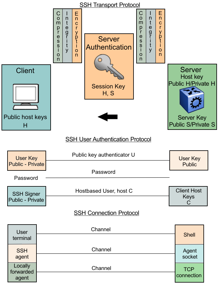

SSH version 2 (SSHv2) protocol is a complete rewrite of the SSHv1 protocol. In SSHv2 the functions are divided among three layers:
The following figure shows the three layers of the SSHv2 protocol.
Separate SSH version 2 protocols
The modular approach of SSHv2 improves on the security, performance, and portability of the SSHv1 protocol.
